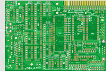

Layout ZX81+38 rev 1,5 finished and checked
This is the new layout of revision 1.5, it has been checked for DRC errors, and this is a screenshot of how the PCB will look like true size is 142mm wide and 100mm deep, so this picture is nearly true size (depending on your monitor): Top
and bottom:

This is the new TOP side of rev 1,6
and this is the bottom side:

May 3, 2022 After more than two year of covid related delay I finally re-started building my own copy
I finished soldering all the sockets and parts on my copy of the ZX81+38! I also tried powering up the board (without any IC's placed) and measured if all IC's received power, and if the polarity was OK, it was, and there were no shorts either. Here is a picture of the result. I have to place all IC's (I should have them), and program the EPROM (27C256R-45PU) using the REVSpace TL866II plus XGecu programmer, meaning I have to install the programmer software on my laptop.
Here is a picture of the built up ZX81+38 PCB:

juni 22 2022, got a free Xtal and 74HCU04, Finished Revision 1.7
will try the new crystal and 74HCU04 next time when I'm at Revspace. I also got An I/O expansion board (8 input and 8 outputs) from the same ZX81+38 enthousiast that gifted the Xtal and 74HCU04. In the meantime I got a few tips and requests from him which led to me creating revision 1.7: The changes (relative to 1.6) are:
  • Changed footpad of crystal oscillator to a footpad that supports both PTH and SMT crystals. You do need an isolator between crystal case and pads when using a crystal with leads if you must use it as a pin through hole crystal, to avoid shorts. When using an SMT crystal, it will come with a plastic base, and shorts are not possible simply solder the wires to the pads from the top side.
  • Changed R29 to 1M, U21 to 74HCU04, also changed RP2 to 8x22K and changed the series resistor R21 to 330 Ohm (was 100Ohm) all as the latest BOM tells you.
  • changed the default JP1 jumping so that there will be 16K of ROM-space, not 8K, if you want to use four separate 8K images then switch JP1 back to 8K ROM-Space. then you can use two switches to drive A13 and A14 with switches, after having disconnected the pre-wired trace between jumpers JP9 and JP10.
  • The same user that gifted me stuff also remarked he had to twist the 5-wire data lead (foil) because J3 was reversed in orientation, this must be the last of many keyboard wiring errors I have made, so I need to also create a specific ZX8138 keypad with wiring 100% compatible with a real ZX-81. note that this means the keyboard data lines on the ZX81+35 are inverted too, I will do no changes to ZX81+35 anymore, sorry.
The new schematic as .PDF File:ZX81plus38 Rev 1,7.pdf
and updated placement file
It happened I uploaded all ZX81+38 revision 1.7 files to GitHub
Updated files, are the Production files (.zip) with all the gerber an drill files to create the PCB, a schematic (in monochrome) of revision 1.7, and a picture of the updated placement file. The earlier updated BOM files is compatible with revision 1.7 and now also has more sources listed for components. To top it all of I uploaded the 8K ROM file for a ZX81 (clone) which is legal as the ROM was freed to the public domain. I'm still planning to release the full set of KiCad files (including extra schematic and footprint libraries) to GitHub in the near future.

July 6, 2022 I made an observation while building up my copy of the ZX81+38 that shook me
I made a (for me) stunning discovery, as I said earlier I derived the ZX81+38 clone from my fully working ZX81+35 clone, which was built up from SMT (surface mount) IC's and in it I exclusively had used 74HC logic, even for the dual four input NOR gate the 74HC4002 which is actually a CD4000 family chip. And certainly the crystal oscillator should not be the wrong kind of logic, initially it was a single-gate CMOS logic unbuffered inverter the SN74LVC1GU04 why I replaced it with a 74HC14 I will never know. So when I read complaints that I had "mixed up logic families" I was initially unconcerned and thought that maybe I had replaced some 74HC ic's with 74HCT ic's, because a DIP version of some IC's were easier to get in 74HCT logic than in 74HC logic, and in my mind not a single 74LS family chip was used. But that illusion was shattered when I was building up the board using my self made component placement drawing and I saw many IC's being listed as LS logic! That is one reason why you will normally not release a design before you build up and test it successfully, as in that stage you are bound to find silly mistakes like that.
Shock-horror how could this be, and why didn't I noticed this obvious error before, I checked the BOM, and indeed there too I noted that LS logic, not HC logic was often used! Now I have no doubt that HC(T) and LS logic CAN BE MIXED, in a 5V powered design, but as I said I did not deliberately changed any HC logic family IC to an LS IC'!
Somewhere something must have gone wrong for this to have happened!
I assume the fault occurred because I re-drew the schematic in KiCad, for my original (paper) ZX81+35 schematic and I remembered from that conversion project that not all IC's I needed where in the KiCad library in the form of DIP 74HC logic IC's, so sometimes I was forced to use to use the 74LS DIP library, and change the logic type (IC label) to 74HC from the original 74LS logic label, in that process something must have gone wrong! All the places where I deviated from the 74HC family and the labeling was changed back to 74LS that is in error!
As the BOM was derived from the schematic, and the build up diagram was derived from the silk screen diagram and the BOM it contains the same errors.
But again, this doen't mean it won't work, it should work, only drawing a bit more current than it should. As I said before I received news that someone had built u this clone with IC's he had on hand, which where military LS logic (54LS logic) and it worked fine. But this does explain why observant copyists of my design noticed the mix of logic, which I completely failed to detect.
I want my designs to be perfect, so I will correct the schematic, the BOM, and the placement diagram.
Another observation I also made is that sockets with machined (round) sockets are very bad at accepting imperfect IC's, so I sometimes needed half an hour to minutely straighten out IC pins, as the socket otherwise would not accept them. Recently I saw a youtube video where a retro-computer repairman repaired an oddly build up C64 by replacing its mixture of sockets and he remarked that he much rather used dual wipe sockets because machined pin sockets are notoriously bad a making reliable contact when a bit of the pins of a DIP IC was cut off, and that dual-wipe sockets were not like the cheap single wipe sockets, but were in fact even better than machined sockets. So please do yourself a favour and use dual wipe sockets not machined sockets.
July 10, 2022 updated rev 1.7 schematic, Gerber/drill and placement drawing
The new schematic rev 1.8 as a .PDF File:ZX81plus38Rev1,8.pdf
And as .PNG picture:
The new placement file, with only HC logic:

July 14, 2022 Updated the layout with correction of NPTH holes and USB connector positions
With help of a real ZX81 PCB, and the enclosure of a real ZX81 I could check if all the non plated holes (for screws) were in their correct positions. I found that many holes were between 0.5 and 1.5mm from their correct location, and managed with a calliper, and ruler to find aberrations, and correct them. I also moved the USB connector o.7mm toward the audio connectors, so the square type-B USB connector could be inserted while the PCB was mounted in the original case, without having to cut away any plastic from the enclosure. I generated updated gerber files, which I will upload to GitHub after checking them with a gerber viewer.
