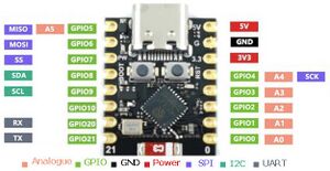

Hardware
I got this ESP-C5-devkitC-1 board, and it worked for me:
- Aliexpress product page https://nl.aliexpress.com/item/1005012416463528.html
- Espressif schematic https://dl.espressif.com/dl/schematics/SCH_ESP32-C5-DevkitC-1_V1.1_20240621.pdf . Actually my board is not exactly like this, the USB-UART is connected to pins GPIO11 (TX) and GPIO12 (RX), not GPIO25/GPIO24.
- Espressif devkit-c page: https://docs.espressif.com/projects/esp-dev-kits/en/latest/esp32c5/esp32-c5-devkitc-1/user_guide.html
It has an onboard antenna. There are also other boards with an antenna connection, which allows using an external antenna. This may be better, I don't know yet.
