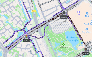

- Crowd-sourced live map of messages received: https://opentrafficmap.org/ Their wiki: https://wiki.opentrafficmap.org
