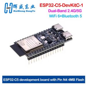

I got this board, and it worked for me:
- aliexpress product page https://nl.aliexpress.com/item/1005012416463528.html
- espressif schematic https://dl.espressif.com/dl/schematics/SCH_ESP32-C5-DevkitC-1_V1.1_20240621.pdf
- espressif devkit-c page: https://docs.espressif.com/projects/esp-dev-kits/en/latest/esp32c5/esp32-c5-devkitc-1/user_guide.html
It has an onboard antenna. There are also other boards with an antenna connection, which allows using an external antenna. This may be better, I don't know yet.
Connect your USB-C cable to the "UART" port. It is connected to an actual USB-UART converter chip and always shows up, regardless of whether the ESP32 is in reset or not.
