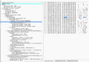

[[File:its-g5-wireshark.png|thumb|right]] | |||

The can be converted for wireshark, for example:
text2pcap -l 105 message.txt message.pcap
Then viewed in wireshark:
wireshark message.pcap
