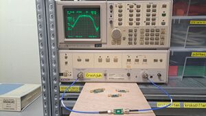

Measuring an ADS-B SAW Filter

Status
The device is overhauled by Crashjuh, with some help from Maxell and PBX
At present, there are again a number of buttons that refuse service.
These buttons would therefore be replaced by new momentary-contact push buttons.
