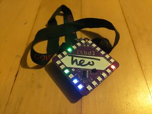

The Badge
Contains 24 blinking RGB LEDs, various support components, a microcontroller and you can actually write your name on it.
Badge image
image of the hackwinkel badge
You can see it in action in [this video]
Both | hardware and | software of the badge are MIT licensed open source.

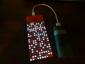

The 'blocktris' game
The game contains 200 RGB LEDs in an array of 20 x 10 pixels controlled by an ESP32-C3 microcontroller module, ideal for playing 'blocktris'.
Blocktris game image
Image of the blocktris game
Both | hardware software of the game are BSD 3-Clause licensed open source.
