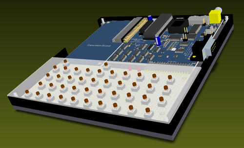

5 January 2016
Here is the latest preview, (updated April 3, 2016) seen from the front of the board, the picture is fully updated, and also includes the planned ZX81+35's expansion board.
The expansion board can also be used as an extender to give the edge connector some people want, either on the left, or by extending the top of the board, even on the back.
A planned enclosure (casing) will enclose both the main zx81+35 board, the keyboard and the optional expansion/extension board to guarantee a sturdy whole.

This is how I envision what a ZX81+35 expansion board could look like
Here is a picture of my (pie in the sky) idea on how a typical expansion board could look like. This one creates a ZON-X compatible sound card, and uses its GPIO's to interface to an µSD-card. It also shows how a ZX81 compatible edge connector can be implemented (it could be an otherwise empty extension board).
