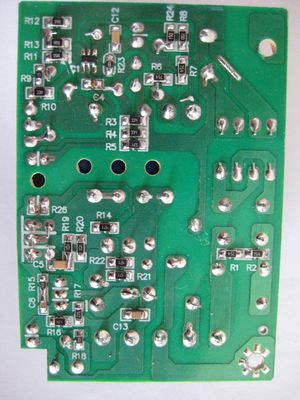

Walter got some more ultra cheap power supplies from AliExpress. The price was still in the 'overly affordable' category, so here's another dissection.
The three bottom left connectors are for the AC circuit, the two bottom right ones adjacent to them are the DC circuit. This one looks almost sensible.
So let's get to the bottom of it:
2,304 × 3,072 pixels (file size: 1.9 MB)
The R2 resistor is sitting on the copper trace of the bottom leftmost connector of previous picture. So it looks like the 240 AC circuit traces are separated by healthy-looking distances. Likewise there is a good separation between the 240V AC and the 5V DC circuit.
