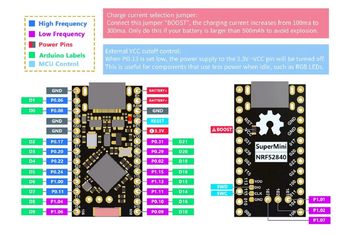

The boards I have are the "promicro" and "supermini". These boards look basically identical hardware-wise.
There is a 4-pad connector to program it using SWD (VDD/SWD/SDC/GND). This can be used to write the bootloader for example. The pads have a spacing of 1.5mm.
The blue LED appears to flash independently of software, this is probably the charge circuit behaving randomly without a battery present. The red LED appears to be under software control.
Pinout/schematic: https://nicekeyboards.com/docs/nice-nano/pinout-schematic
