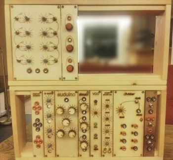

Project Modular Synth
A do-it-myself modular synthesizer
Status In progress
Contact pinoaffe
Last Update 2017-09-20
Working Modules

Here is an outdated version of the plans I've been working with. I wrote em for myself, so they might not be very useful for others.
Plans for a DIY Modular Synth
System
Dimensions
  • close to 4U: 180 mm
  • module width will be x*10mm, so far smallest is 30 mm
  • front panels will be 2.7mm high
  • standard pot knobs are ....... mm in height
Design
  • CV and audio both on banana jacks
  • folding box with piano hinge, collapsible feet and removable back panel?
  • serge modules might fit, though i might have to do minor adjustments to my cases
  • front panels and pot knobs will be made from 2.7 mm plywood using a lasercutter
  • front panel design will incorporate arrows and curves to signify what knob/plug does what
  • so far, i've mostly used the "Arial" font on frontpanels
  • maybe:
    • standardized rectangular wooden format with dovetails and a back?
    • make these 200mm * x00mm in outer dimensions, with a standardized inter-connection system?
    • same format as modular book cases i plan to make?
    • threaded inserts?
    • wooden pegs?
    • wont use rails, but screw directly into the wood?
