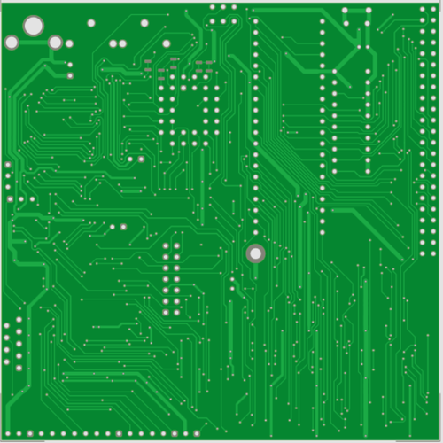

Well, the PCB for revision 2.2 of my ZX81 + 35 (35 years after the launch of the ZX81, and almost exactly a year after version 1.0) was  finally ordered, and I got an e-mail from Eurocircuits with a preview of the PCB, which I don't want to keep from you.
[[File:PCBPreview ZX81+35 rev 2.2 top.png|500px|thumb|left|Top view]] [[File:PCBPreview ZX81+35 rev 2.2 bottom.png|500px|thumb|right|bottom view]]

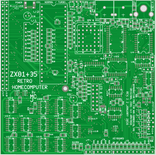

29 DECEMBER 2015
Finalized the revision 2.2 layout, just before year end.
This is how the new revision 2.2 layout looks, note that unlike the previous version I left out copper fills.

Here is the latest preview, seen from the front of the board, the picture is fully updated, and also includes the planned ZX81+35's expansion board.
The expansion board can also be used as an extender to give the edge connector some people want, either on the left, or by extending the top of the board, even on the back.
A planned enclosure (casing) will enclose both the main zx81+35 board, the keyboard and the optional expansion/extension board to guarantee a sturdy whole.
10 January 2016
I have also made a new component overview drawing, which I can use when placing components on the board for reflow soldering:
Top view
bottom view
