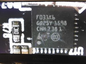

F031K6, photo Cmpxchg

1. Software update process
The STM32 32 pin microcontroller seems to been modified with the SWD debug pins cut off. The BootP pin is still accesible. The UART is accessible. Flashing the microcontroller thus has to take place via de UART, or, with effort, by touching up onto the exposed tinned copper metal cutoffs, while avoiding the SMT components. Another option is to buy an off-the shelf STM32 component, put in an 'opensource' bootloader and firmware, cut off the pins to make it fit on the PCB, and use hot-air to put it on/replace it, and work from there.
