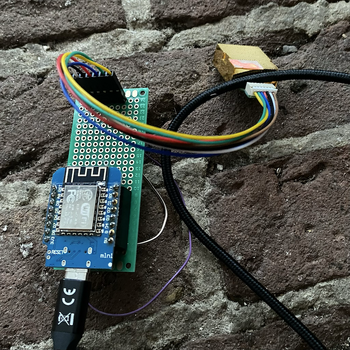

Instead of living with breadboards I soldered headers onto a project board and wired them together so that the d1 can be plugged into the board and the sensor can be plugged into the board. This should let me redo the board with less wear and tear on the d1 and the sensor, and I bought the extension cable for the sensor to enable this.
Eventually I want to build a case or a stand to hold the board and sensor, and may tack the sensor into place against the board.
