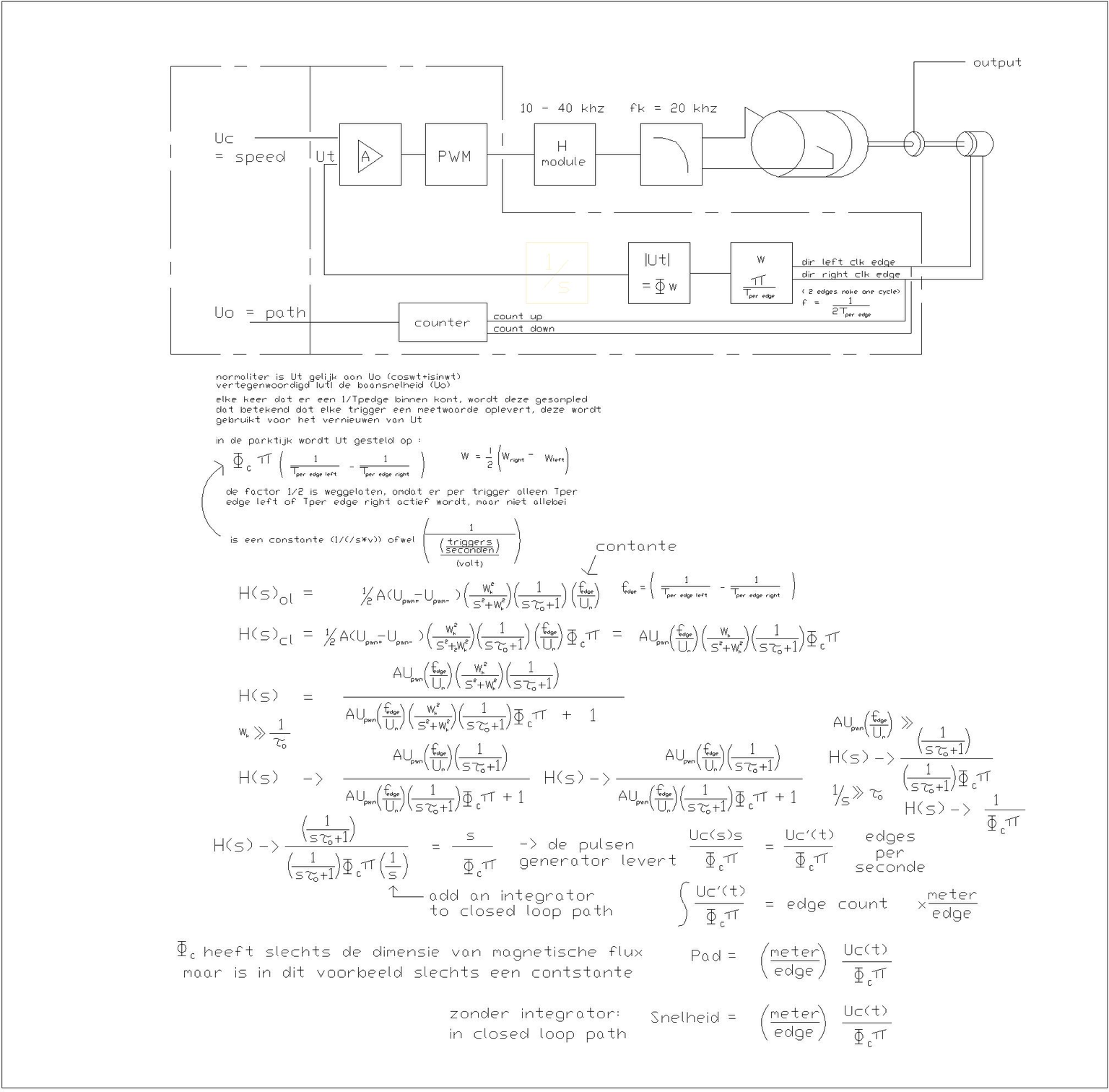

We're basing this project on an old X-Z traversing unit originally made for measuring air velocity distributions in wind tunnels at a metrology institute. The current motor controllers, however, seem to be made for a fixed speed and it's probably easiest to replace the electronics altogether.
A Z-axis seems required to control the torch height. It won't need to move very far, quickly or precisely, though.

connection diagram:
blokdiagram sturing plasmasnijder,
