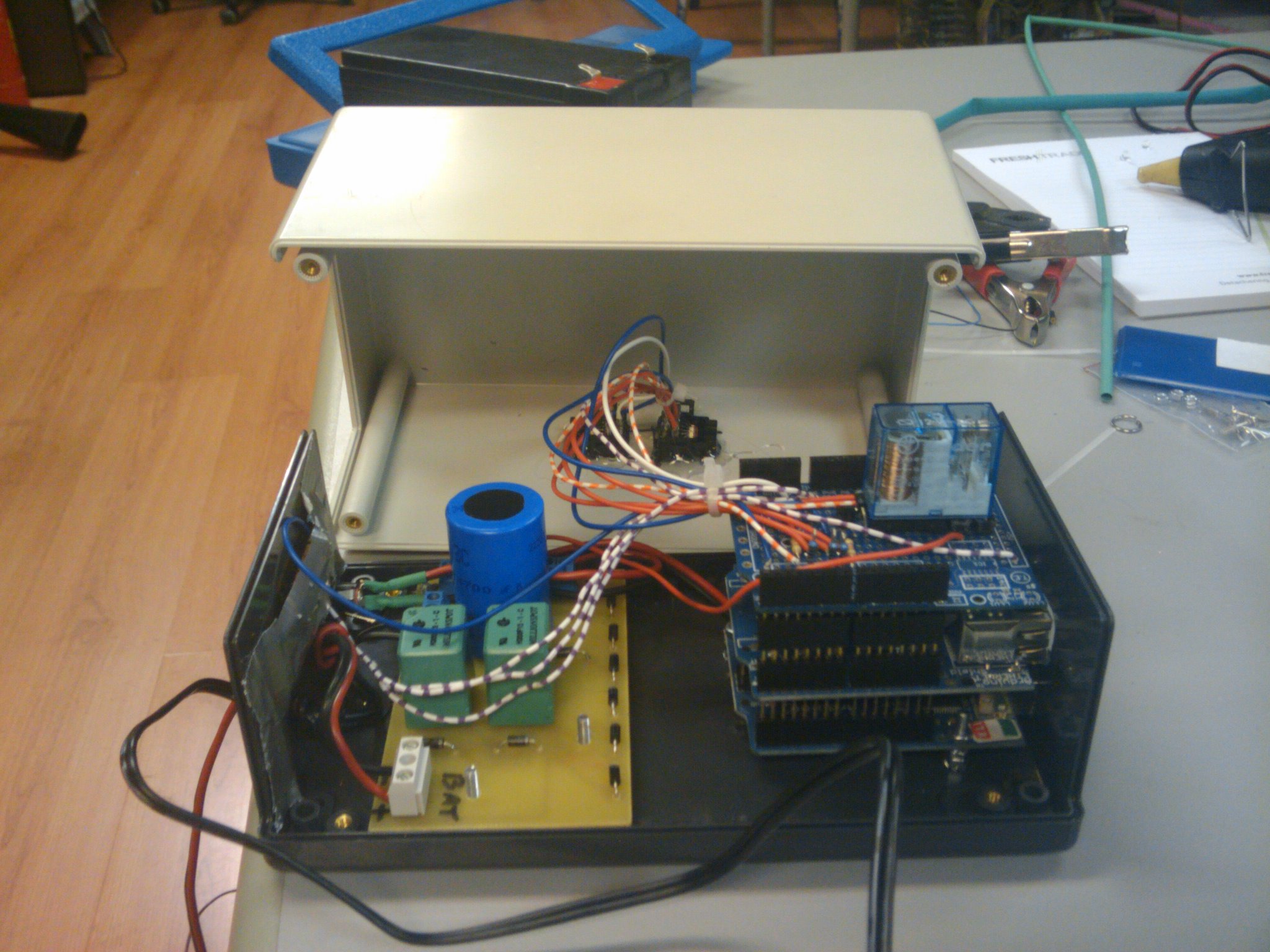

However, the solution with the serial port and pc appeared finicky, partly because we did not create an SMD board but soldered wires to the tiny chips. Also, the pc solution is somewhat more involved to set up in such a way that the electronic lock still works when the power is down. Therefore, we went back to arduino, and implemented the whole thing as an autonomous system based on an arduino, some code and a handful of hardware.

Update: pin A4 is connected to a relay on the legacy remote door opening system, and is pulled to ground to trigger opening of the door.
Pin D8 is connected to the reset pin of the ethernet shield. I had to bend the reset pin of the ethernet shield so that it does not connect to the arduino itself. This is necessary for the old-design ethernet shield, which does not have a reset circuit on-board and will not initialize properly on power-up. There is code in the arduino sketch to manually reset the ethernet shield from within the program.
What this is still missing is a zener to protect against power surges on the one-wire bus, and perhaps some protection against 12v going back into the arduino if T1 shorts. Of course, you could use a CC instead of a CA RGB led.
Battery backup unit
Connections:
  • K4-1: charger +
  • K4-3: charger -
  • K3-1: battery +
  • K3-3: battery -
  • K1-3: ~12V to arduino shield
  • K1-2: GND
  • K1-1: ~9V to arduino VIN
  • K2-3: GND
  • K2-2: +12V from mains power
  • K2-1: GND
We're using a 12V 7.2Ah lead-battery, with intelligent charger to keep the battery charged without overcharging.
PCB film (postscript, A4): [1]
Top view of the bbu with parts:
