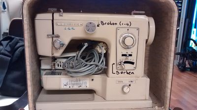

Since very recent, RevSpace has an old sewing machine. It's an entry level VendoMatic from 40 or 50 years ago, which means it's probably better built than anything new you can buy on today's non-professional market.
B0rken
moveZig()
It has a few broken bits around the zig-zag function. As a consequense, you can only sew in a straight pattern. Offsetting the needle from the middle does still work. This function is indicated by the B0rken-arrow
Stitch patterns
The pattern stitching functions, as selected by the selection wheel indicated with Broken(1-4), is broken too. Only the M-function works. M probably stands for manual, but it means either straight or plain zig-zag sewing.

Rectangular panel
In the rectangular panel on the right, there are a knob, a push button and a LMR slider. these work just fine, and are for
  • Knob: Stitch length - a value from 0-4 for the distance between the individual stitches. For regular sewing, a value between 2,5 and 4 is good.
  • Push button: Push to engage reverse, mostly for starting and finishing a seam
  • LMR slider: Move the needle from left to right a bit. Normal operation is M (middle)
