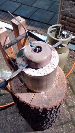

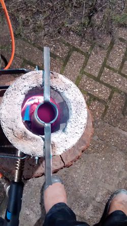

Initial design
Gori made a small foundry out of a soup can, a propane blowtorch and some refractory. This works reasonably well and never fails to gather a crowd. It only melts approximately 0.2 l of aluminium, and this is clearly not enough to do any real work.
