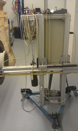

X-Z traversing unit before any modifications
The working mechanics
Once upon a time, three consecutive interns at VSL made a X-Z traversing unit to automatically measure wind speed velocity distribution of one of VSL's primary standars. This traversing unit was put out of use over half a decade ago, and was finally put on the scrap metal list. If it wasn't for a hackers intervention, it would have been there by now. Luckily it can now have a second life in the spark shack.
The X-Z traversing units has a DC motor for each direction of travel. These motors are coupled to a gearbox and a rotary encoder. A toothed belt then transfers the rotational motion into a linear motion.

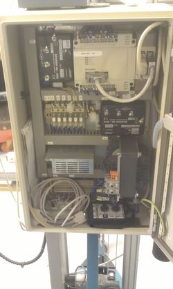

Control electronics with DC-motor controllers and Mitsubishi PLC
  • The motors move the X and Z axis when operated by the joystick controller.
  • The X and Z directions have smooth movement over an approximate 1 x 1 m range
  • Speed is adjustable by means of knobs inside the contol cabinet.
  • The two motorcontollers work [[1]]
Hardware that needs to be sorted
  • The onboard RS-232 PLC (Mitsubishi something or other) may or may not work. If it still works, we need a way to program it. Possibly it's easiest to take out the PLC and put an Arduino or Rpi in there instead
  • Interface with the plasma cutter (relay, some cable and a plug to match the plug that's already on there)
