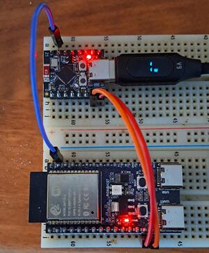

How to wire it up, what I did:
  • Put both the esp32-c3-supermini board and the esp32-c5-devkit-c1 on a breadboard
  • Use male-male dupont wires to connect:
    • 5V to 5V, GND to GND, esp32-c5 TX to esp32-c3 RX
  • Programmed the esp32-c5 with firmware
  • Plug an USB-C cable into the esp32-c3, programmed it with firmware, now it's powering both the esp32-c3 and the esp32-c5
Connections
ESP32-c5 ESP32-c3 Remark
GND GND shared ground
5V 5V raw power
U0TXD/GPIO11 RX/GPIO20 Data link
