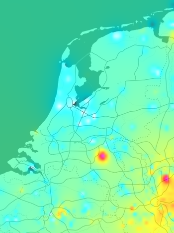

Visualisation
The general idea is to create an image, with a map at the background and the atmospheric particulate matter concentration overlaid on top.
Background map

Interpolation
Since we only have data at a set of discrete points, the concentration at other points is estimated by combining data from all sensors using inverse distance weighting, in particular using the distance *squared* as the weighing factor in a weighted average. So a nearby sensor has a large effect and a far away sensor has very little effect, contributing only a little bit to the global average.
To calculate the distance, I use a very simple approximation:
- calculate the "middle" of the map (average latitude/longitude between top-left and bottom-right);
- calculate the "km-per-degree-latitude" at the middle for latitude as 40000 km / 360 degrees;
- calculate the "km-per-degree-longitude" at the middle for longitude as the number above multiplied with cos(latitude);
- determine the difference in longitude and the difference in latitude;
- convert both to km using the factors calculated earlier;
- calculate the euclidean distance.
A better way would be to use the 'great-circle-distance' and possibly even account for the fact that the earth is not perfectly spherical, but I like to start simple and this makes the calculation a lot faster.
Pixels that are not within a certain distance of any sensor station (e.g. 25 km) are rendered as grayscale, to indicate a geographic limit of each sensor.
Only sensors within a reasonable range of the map are taken into account, currently this is an area of 9 times (3x3) the visible area.
PM10 values higher than 500 ug/m3 are simply ignored in the software.
Colour range
The colours I'm using (a kind of inverted spectral range from blue to red):
- 0 ug/m3: fully transparent white (#FFFFFF)
- 25 ug/m3: semi-transparent cyan (#00FFFF)
- 50 ug/m3: semi-transparent yellow (#FFFF00). This is the threshold for the maximum daily average for PM10 in the Netherlands.
- 100 ug/m3: semi-transparent red (#FF0000)
- 200 ug/m3 and higher: semi-transparent purple (#FF00FF)
Values in between these levels are interpolated linearly with respect to the RGB colour value and alpha channel.
This scale is approximately logarithmic, with each step being twice as big as the previous one.
