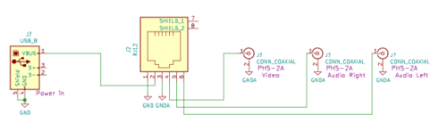

November 15, 2017 designed "base system" for SNES JOYPAD
Also designed a separate PCB for the "base station" with the power input and audio and video outputs, as the first version, it is connected to the joypad with a six-wire cable with RJ-12 modular connectors (used, among other things, by a telephone handset). here is the (rotated) .PDF: File:SNES JOYPAD BASE.pdf.
and a picture:
