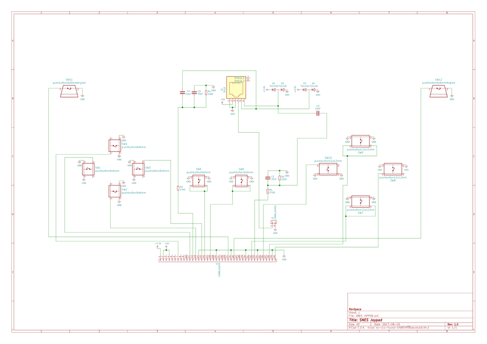

October 11, 2017 Redrawn the Schematic with KiCAD
This is the new schematic, drawn in KiCAD. File:SNES JOYPAD.pdf I also started on component placement.
