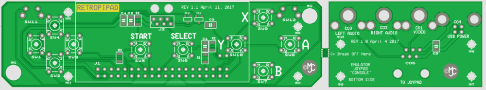

March 14, started with PCB layout
Started with layout work, trying to fit it all on a single sided board, making use of the fact that switches can also be used as "jumpers", which is a bit tricky. Its also hard to route it all on a single sided board, need to use my "bag of tricks". However its a nice challenge and will keep the cost of the PCB down. I will try to route the important traces (video + video GND) the shortest. Need to remember to add 4 mounting holes for a piece of perspex over the switches, which could also be used to replace the case. At the end of the evening I had managed to do a large part of the layout work, when someone found it necessary to switch off the power, and as my laptop doesn't have a battery I lost some work, (just 15 minutes or so, as I save often).
March 21, PCB Layout finished
Finished the layout, it looks like this:
Note, this is a single sided PCB, all copper is on the TOP-SIDE only! I have used the fact that the button pins are connected along the long axis to each other, where I use to make connections, (Bridges) the connection is marked with a red line.
All capacitors and Resistors are easy to solder 1206 size, while the dual diodes are equally easy to solder SOT23's.
This is the schematic: File:Emulator JOYPAD schematics.pdf

I've uploaded the PCB to my favorite PCB manufacturer Eurocircuits, to see if they could make them (if there are no violations of their production rules in it). This is the preview I got from their checkout program, but note that I will probably NOT use them, as they ask about €7 per piece for them, which I think is much too expensive. Also I will wait until I also have the other "console" PCB ready, so I can "panel" the two together.

Modified the schematic to also include the console part, with three RCA (Tulip) connectors for Stereo Audio and Composite Video, an USB Type B (square) USB Power input, and an RJ-12 (think 6-wire telephone jack) connector). And also added the "console" part as a break off part to the main PCB. Pictures coming soon. P.S. I have had the idea to add 1mm holes in the PCB at the center of each button, so the PCB can be used as a drill template for the holes in the enclosure, so some traces have to be modified to make place for these holes.
March 29, Finished PCB with "console" part
Here is an artist impression of the finished PCB:

I decided to give my RETROPIE JOY-PAD the name "RETROPAD". Finalized the PCB layout and schematics, generated production files (Gerber and Drill Files)
April 10, 2017, Tested PCB layout for product-ability
Uploaded my new combined PCB design to a PCB manufacturer to test for errors, and found it did contain two overlapping drill holes (in the break off via rows) and the absence of some needed data in the gerber files. Still the preview pictures is nice, and I don't want to keep it from you, so here it is:
