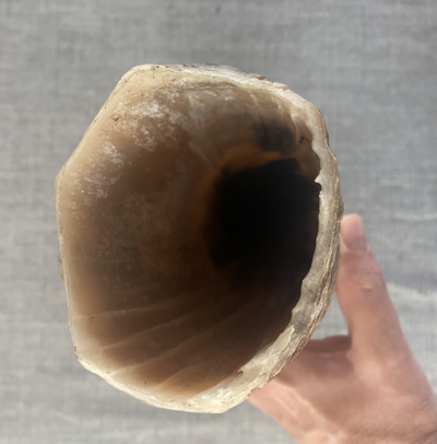

If you shine a bright flashlight into the horn in a dark room it lights up and you can get a sense of how far down the horn it is hollow.
End-on view of a water buffalo horn
Water buffalo horn before it was cut

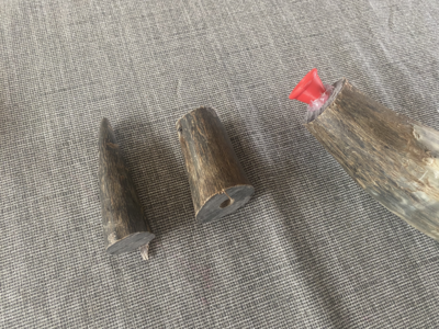

We used a hand crosscut saw to cut off the tip of the horn. It was still solid where we cut it.
So we cut it again a bit further down, and ended up with a hole. The remaining rim was too thick to easily make a buzzing noise against.
Tip and a section cut from the water buffalo horn, and a mouthpiece glued into the resulting hole.
Off-cuts from making the water buffalo Vuvuzela
Luckily I have been making mouthpieces for my French Horn and had some spare early test runs.
We jammed one into place and it makes a very loud noise.
We used hot glue to fix the mouthpiece in place and we now have something which functions as a Vuvuzela.
