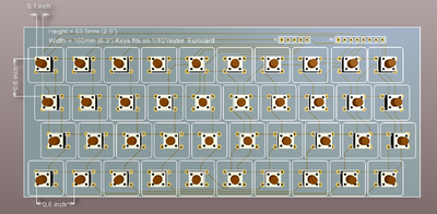

I have also been busy designing a solution for the keyboard.
My solution is to use commercially available cheap 6x6mm buttons, which (with some effort by bending the pins a bit) can be mounted on an EuroCard sized piece of 1/10"raster perfboard, the result would like something like the picture on the right.

The ZX14 is a much improved Sinclair ZX81 clone built with the modern materials techniques and components of 2014.

ZX14 keyboard preview
I have also been busy designing a solution for the keyboard. My solution is to use commercially available cheap 6x6mm buttons, which (with some effort by bending the pins a bit) can be mounted on an EuroCard sized piece of 1/10"raster perfboard, the result would like something like the picture on the right.
Here is the schematic of the keyboard: Bestand:KB matrix schematic.pdf
I also designed a new keyboard overlay suitable for such a keyboard with the keys going through holes in the overlay. Here is a drawing showing how it would look:
Here is a correctly scaled .PDF. Nieuw_keyboard_ZX14.pdf
