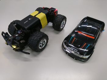

The car next to the original body.
It's a "1:12 monster truck". Since the battery was missing, I had to find a way to get around 9V from something bigger than a 9V alkaline battery and less crappy than anything NiCad or NiMH. It's 2018 after all. I didn't feel like building my own Li-Ion pack, but I could have done that. Instead, I went for my big USB power bank which supports Power Delivery 2.0 and a ZY12PD module set to 9V, which I both happened to have already.
Inside the car is a large motor for driving which draws up to 3 A and a small motor for steering which draws around 500 mA. There is one PCB with the RX-2B chip and 2 H-bridge circuits.
I removed the body because it didn't fit well with the power bank. The body did have LED's, but I replaced those with more powerful LED's which I hotglued to the base. With almost 100 Wh of energy taped to it, the car worked practically forever. Presumably sligtly better than before, because the voltage does not drop when the battery drains like the original would have.

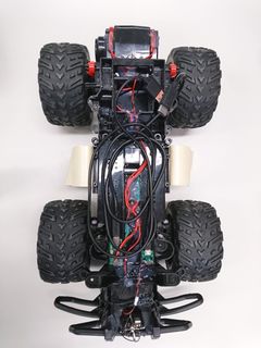

Killing transistors
Bottom left: USB PD module set to 9v. Bottom right: USB micro breakout.
So, that was when I grabbed a NodeMCU esp8266 module from one of our parts boxes, wrote a bit of µPython to make it do PWM stuff on 4 pins, and connected those directly to the existing electronics in the car. It worked. I could connect to the repl over wifi and type forward(0.5) and it would move at half speed. So I played around with this for a few minutes until I accidentally turned on 'left' and 'right' at the same time. Shortly thereafter I learned what an H-bridge is and how transistors die. Luckily we have the same type of transistors in stock, so replacing one would be easy. But for some reason more transistors died. I have replaced all of them at least twice. I started debugging the board, but the only thing I could find out was that it would short out no matter what I tried.
The next morning another revspace participant gave me a motor driver module. This is based on the ST L298N chip, which has 2 integrated H-bridge circuits with protection against enabling both sides. I replaced all the electronics in the car with this board and the NodeMCU and called it a day.

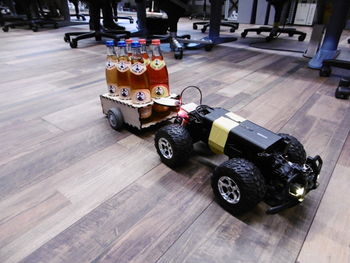

Trailer
Say cheers!
I decided that my car needed to become more useful. So I built a beverage trailer for it. The 'wood' is actually IKEA SLÄTTEN, which is actually 5,3 mm MDF with a nice fake wood pattern printed on it. I bought wheels at the DIY store nearby but they turned out to be way too small, and we had better wheels at the space, so I made a rev2. It it capable of carrying 6 full 500ml bottles of Club Mate, which are around 900g each, and the trailer itself is also around 900g. So the car can successfully carry over 6kg on top of it's own 2kg weight!
