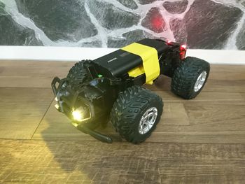

It's a "1:12 monster truck". Since the battery was missing, I had to find a way to get around 9V from something bigger than a 9V alkaline battery and less crappy than anything NiCad or NiMH. It's 2018 after all. I didn't feel like building my own Li-Ion pack, but I could have done that. Instead, I went for my big USB power bank which supports Power Delivery 2.0 and a ZY12PD module set to 9V, which I both happened to have already.
Inside the car is a large motor for driving which draws up to 3.5 A and a small motor for steering which draws around 500 mA. There is one PCB with the RX-2B chip and 2 H-bridge circuits.
I removed the body because it didn't fit well with the power bank. The body did have LED's, but I replaced those with more powerful LED's which I hotglued to the base. With almost 100 Wh of energy taped to it, the car worked practically forever. Presumably sligtly better than before, becase the voltage does not drop when the battery drains like the original would have.
