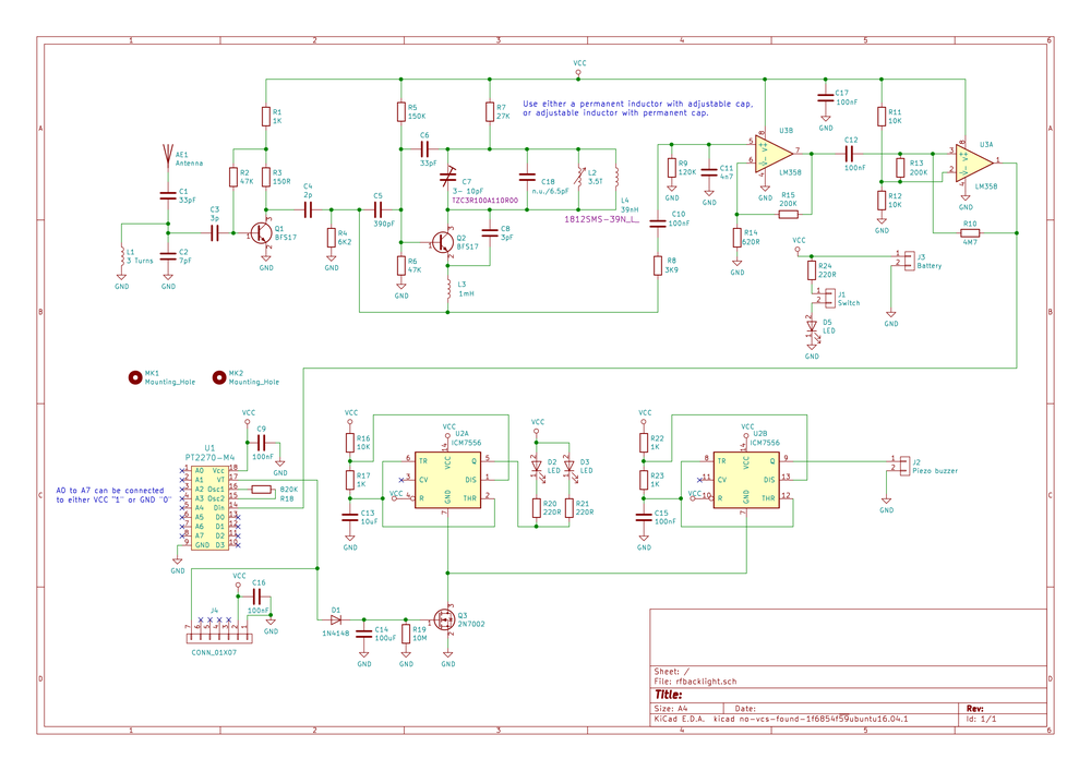

My nephew asked me if I could help him design a school project, a bicycle back light that could be remotely controlled to blink and emit sound.
I engineered a solution around a 315MHz receiver. This is the (updated to rev 2.1) schematic. File:RF Achterlicht rev2.1.pdf
