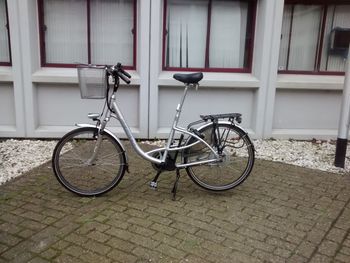

The bike!
We have bought an ANWB (2010-11 era) NiMH electric bike. It is gearless, 2x26" low aluminum frame, with an toolless adjustable long seatpost. So it's very simple, virtually maintenance free and (hopefully) pretty foolproof.
The motor is a 250W DC brushed motor. The bike runs on 24V, originally NiMH. At the moment, the battery has been fitted with a 6S4P li-ion battery (approx. 120Wh).
