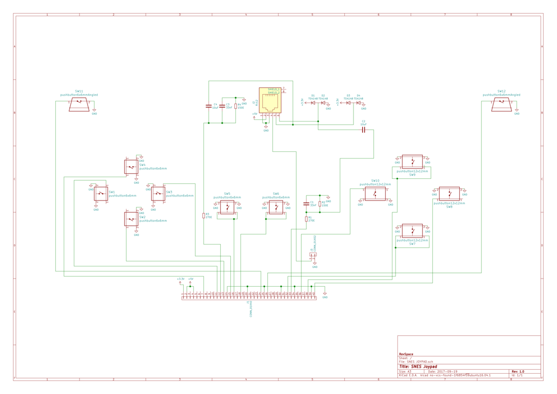

I also made last minute changes to the schematic based on the latest insights (switched the two audio channels to simplify the layout). The schematic can be downloaded here: Bestand:Emulator schematics.pdf

This is the schematic: Bestand:Emulator JOYPAD schematics.pdf

I want to do a redesign the RETROPIPAD using the newer more future proof KICAD CAD system under Linux I have now started to use, and at the same time I want to use slightly larger ABXY buttons that can use coloured plastic top caps. This because it seems interest in the SNES mini is now growing, and the Raspberry PI Zero can also emulate SNES games.
I have acquired data about somewhat larger buttons for which you can buy key caps in various primary colours, which I'm going to use in this more SNES oriented re-design. I finished large parts of the schematic in KICad, drawing the schematic in a style resembling the relative positions of various components on the PCB.
October 11, 2017 Redrawn the Schematic with KiCAD
This is the new schematic, drawn in KiCAD. Bestand:SNES JOYPAD.pdf I also started on component placement.
