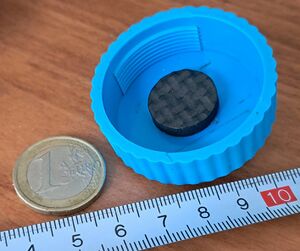

[[File:bt785-cap.jpg|right|thumb|Top cap]]
The water meter takes 4 AG-13 as power source (in series).
There are o-ring seals on the top cap and on the measurement probe part on the bottom.
The measurement probe connects through an 8-pin header (2x4 connectors, looks like 2mm spacing), male end on the meter, female end on the probe.
Perhaps we can 3d-print a replacement cap, put a permanent 5V power cable through it, so it is not reliant on primary batteries anymore.
There are o-ring seals on the top cap and on the measurement probe part on the bottom. The measurement probe connects through an 8-pin header (2x4 connectors, looks like 2mm spacing), male end on the meter, female end on the probe.
