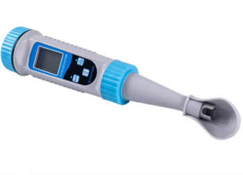

This page is about reverse engineering the BT-785, an inexpensive Tuya-compatible water electrical conductivity (EC) meter. It measures EC and temperature, and has a display and communicates its reading over Bluetooth Low-Energy (BLE) to the Tuya app on a phone. The goal is to understand the communication protocol so we can communicate with it from the raspberry pi in the Karaburan project.
Github repository with Python code: https://github.com/bertrik/bt785

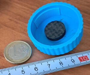

Top cap
The water meter takes 4 AG-13 as power source (in series).
There are o-ring seals on the top cap and on the measurement probe part on the bottom. The measurement probe connects through an 8-pin header (2x4 connectors, looks like 2mm spacing), male end on the meter, female end on the probe.
Perhaps we can 3d-print a replacement cap, put a permanent 5V power cable through it, so it is not reliant on primary batteries anymore.
Cap specifications:

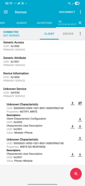

BLE characteristics in NRF-connect
On the lowest level, it uses bluetooth low-level with the GATT profile on the right:
Most important seem two characteristics:
  • 00000002-0000-1001-8001-00805f9b07d0: module to phone, notifies of data from the EC meter
  • 00000001-0000-1001-8001-00805f9b07d0: phone to module, we write data to the EC meter
