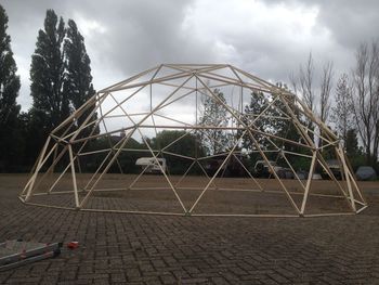

Morphje is building a geodesic dome. This page houses all related information about this project.
Background
I've always wanted to build a geodesic dome. That's basically it. I positively enjoy the beautiful shape, it's geometrics and sturdiness using only basic materials. The round shape makes it an ideal candidate for high wind sites, since the drag coefficient is very low. For a 9.1 meter dome, the wind load is only 500 KG in a gale force wind (8 bft).
Project goals
At the hackerspace, bigger is better and when doing it's worth overdoing. The only thing i'm overdoing is it's size: 9.1 meter in diameter. All materials are chosen for lightweight, low cost, but still be able to carry my own weight.
- Total costs: <400 EUR
- Primary material: wood (pine 22x48 mm)
- Size: 9.1 meter
- Height: 3.7 meter (or 5.4m when extended to 5/9 3v)
- Type: 4/9 3v Krushke dome

Custom tools
Actual full build
