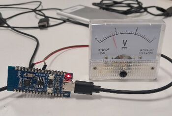

=== Analog panel meter ===
Get a basic panel voltage meter, make sure of the following:
* it measures *DC voltage*
* range is *3V*
Typically sold as "85c1-v" 3V DC.

Analog panel meter
  • it measures *DC voltage*
  • range is *3V*
