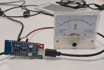

Analog panel meter
Get a basic panel voltage meter, make sure of the following:
  • it measures *DC voltage*
  • range is *3V*
Typically sold as "85c1-v" 3V DC.

Hardware
ESP32c3 luatos board pinout
Luatos ESP32C3
This module (I recommend the one with serial chip) seems to work quite well so far:
  • Senses mains waveform from surroundings with just a wire into its ADC input, using the 'phase' software algorithm
  • Clock crystal appears to be accurate, ESP32c3 datasheet claims it requires a 10 ppm crystal (or 0.5 mHz at 50Hz). Measured value corresponds to https://mainsfrequency.com
  • Has WiFi, works with WifiManager library, so can easily push measurements to MQTT over WiFi for example
  • Inexpensive, only 3 euros or so
The ADC1/UART1 RX pin is the input for 50 Hz. You can just leave that unconnected and it will pick up 50 Hz, or perhaps connect a short piece (20 cm or so) of wire to it.
