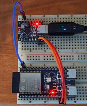

How to wire it up, what I did:
- Put both the esp32-c3-supermini board and the esp32-c5-devkit-c1 on a breadboard
- Use male-male dupont wires to connect:
- 5V to 5V, GND to GND, esp32-c5 TX to esp32-c3 RX
- Programmed the esp32-c5 with firmware
- Plug an USB-C cable into the esp32-c3, programmed it with firmware, now it's powering both the esp32-c3 and the esp32-c5
| ESP32-c5 | ESP32-c3 | Remark |
| GND | GND | shared ground |
| 5V | 5V | raw power |
| U0TXD/GPIO11 | RX/GPIO20 | Data link |
