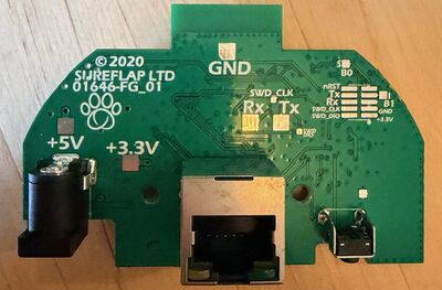

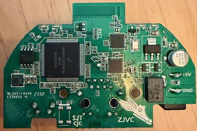

PCB van voren en van achteren.

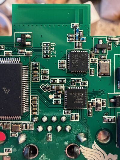

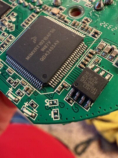

Specifieke zoom-in op de chipset
- Microcontroller: https://www.nxp.com/part/MIMXRT1021DAF5B
- Flash: https://www.macronix.com/Lists/Datasheet/Attachments/8933/MX25L3233F,%203V,%2032Mb,%20v1.7.pdf
- Zigbee: https://www.microchip.com/en-us/product/at86rf233
- Ethernet: https://www.microchip.com/en-us/product/ksz8081
