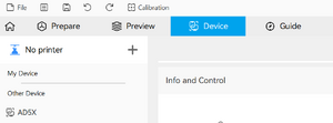

1. Go to 'Device' Tab
2. Click on the '+' icon
3. Click under Other Device on AD5X

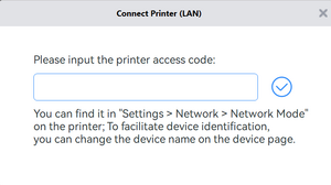

4. A popup will show. It will ask for the printer access code. This will show on the 3D printer itself under "Settings (gear icon) > Network (wifi icon) > Network Mode".
5. The FlashForge AD5X will now show up under 'Device List' in Flash Studio.
