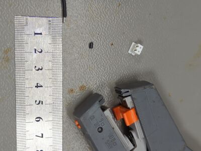

Cut a fresh piece using flush side-cutters.
Strip the wire down to about 2.5 mm. Make sure you do not strip more than 3 mm. Twist the strands it into a bundle, but do not overdo it.

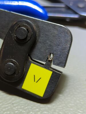

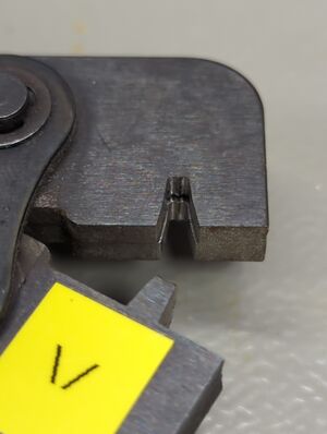

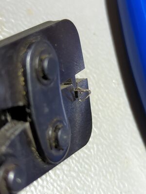

Take a look at your crimping tool and notice the following:
  • the bottom part has a wide and a narrow part
  • the top part has a higher and a lower part
Imagine the following: this is how the wire will be positioned in the crimp once it's in the tool. Notice how the outer v-section will hold the insulator, while the inner v-section will hold the conductor.

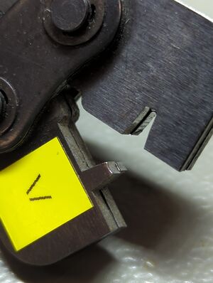

But first we must position the crimp itself in the tool.
Pointers:
  • The outermost v-shaped part of the crimp will later be positioned on the wide part.
  • The hook should be fully sticking outside the tool on the other end.
  • If you fuck up during the positioning of the crimp at any time, you should not continue crimping. Instead, push up the un-fuck lever on the tool so that it opens up again:
While the tool is fully opened and held with one hand, grab the crimp and lay it correctly in the tool. Then close the tool slightly such that it clicks once. The goal is to keep it in place while allowing you to insert the wire into the crimp.

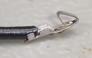

Insert the wire into the crimp. This is the tricky part, because is has to be aligned such as we saw before. If you're lucky the insulator will hit the conductor clamps during insertion. If you're unsure or find this too difficult, remove the crimp, crudely apply the wire into the crimp, then position the crimp (with the wire already more or less in the correct position in the crimp) into the tool.

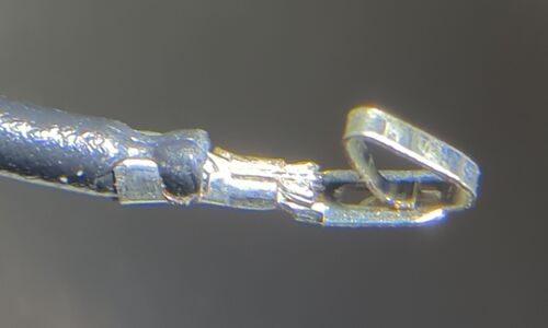

Press the tool firmly, it will open up once you pressed it hard enough. This is a proper example of how the result should look like:
Check: pull on the wire, the crimp should not let loose.
