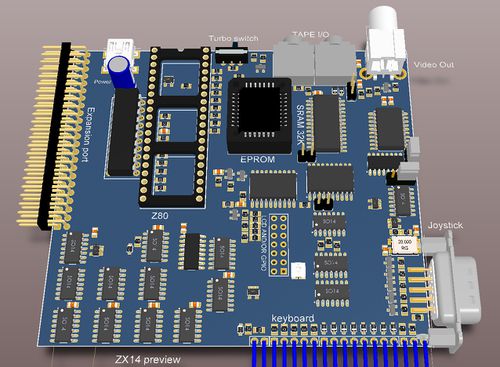

A 3D rendering (preview) of the ZX14 can be seen on the project page, here: [1]

Early 2014 I endeavored to design my own "modern version" of the ZX-81, with all the improvements I could think off, and using modern techniques and components, I'm calling my effort the ZX14, as both a tribute to the ZX80/81 and the MK14 that came before it.
At the moment, (mid April 2014 as I'm writing this) I have finished the Schematic, and am starting to design the PCB for it, which hopefully will fit on a 10 x 10 cm dual sided PCB. I'm trying that because a 10 x 10 cm PCB is often the largest size that extremely cheap (Chinese) PCB manufacturers can handle. Also, I'm planning to use a standard Eurocard sized perfboard with 1/10" raster for the hand wired keyboard, using cheap 6x6mm buttons for keys.
My calculations have shown that for small numbers of devices, the PCB is the most expensive component. Buy one 15x15cm sized PCB, from a normal manufacturer, and you will pay around 50 euro for one, but this will drop to 25 euro for three, or even to 5 euro if you order a hundred, but most people who want to build one only need one PCB, so I want to design one that is as affordable as possible. By limiting the size to 10x10cm I hope to make it possible to find a manufacturer that can make them for around 10 euro in single units.
