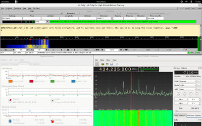

- rtl_tcp on RasPi over the network --> works! (1024000 samples/second seems to go fine when both are on a wired connection)
- VNC performance with gqrx and dl-fldigi --> usable with JPEG compression and 8 bits of color (why not SPICE? http://www.spice-space.org/)
