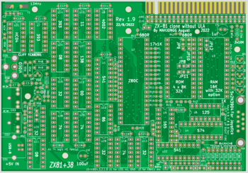

April 10, ZX-81plus38 PCB is finished
working from home, because of the corona crisis I finished the PCB layout. Made all pre-wired jumper connections accessible from the back side, and placed some descriptive text on the back about what these jumpers do. Also added a default wire for 16K/32K RAM with the default of 16K, for best compatibility with the original with a 16K memory pack. Don't forget to place the two jumpers for inverse video mode, and place default jumpers on them, in the position that pleases you, but don't forget that the real ZX-81 displayed black text on a white background. One jumper inverts the bits, another determines the "fill in color", with this setting wrong white or black stripes can appear between the letters. JP4 is normally left open, unless you are using an NTSC TV instead of the normal PAL TV. JP1 only has to change if you use a larger (than 8K) (E)PROM or OTP-ROM. When using a Atmel AT27C256R (32K) the code fits four times in the available size, I would recommend programming four identical 8K copies in the ROM.
This is a picture of the final PCB: Top:
and bottom:
I also made a component overview drawing

Layout ZX81+38 rev 1,5 finished and checked
This is the new layout of revision 1.5, it has been checked for DRC errors, and this is a screenshot of how the PCB will look like true size is 142mm wide and 100mm deep, so this picture is nearly true size (depending on your monitor): Top
and bottom:

This is the new TOP side of rev 1,6
and this is the bottom side:

April 17, 2022 I Produced a component placement diagram for rev 1.6
To assist building up my own prototype board, I have drawn a component placement diagram, while editing it I discovered how much this version has changed in regards to the version I used as a basis, (I think it was revision 1.4) but AFAIK this diagram is now correct for a revision 1.6 board. I will soon used it, and hopefully, if there are any problems with it I will catch and repair the errors. While doing this I also discovered a few small corrections in the Bill of material (BOM) file, and corrected those too. In the schematic a few resistors were listed as 640 Ohm, that is incorrect they should have been 680 Ohm, 640 ohm isn't a standard value, also an extra 680 ohm was inserted in the nWAIT signal.
here is the drawing:
I finished soldering all the sockets and parts on my copy of the ZX81+38! I also tried powering up the board (without any IC's placed) and measured if all IC's received power, and if the polarity was OK, it was, and there were no shorts either. Here is a picture of the result. I have to place all IC's (I should have them), and program the EPROM (27C256R-45PU) using the REVSpace TL866II plus XGecu programmer, meaning I have to install the programmer software on my laptop.
Here is a picture of the built up ZX81+38 PCB:

August 23, 2022 Repaired joystick logic in revision 1.9
here is the revised schematic for revision 1.9:
and the PCB preview (top):
and here is the new placement drawing for revision 1.9:
