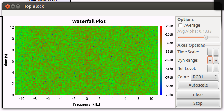

The first HABamp test
GNUradio, tuned 102,7 MHz.
