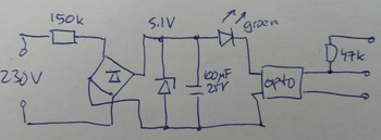

The circuit to sense the 50 Hz is this mains module sold on Aliexpress, with a small modification. The modification is that the smoothing capacitor has been removed, resulting in a 100 Hz signal going into the optocoupler.

- pin GND: connected to the GND pin on the mains module
- pin D5: connected to the optocoupler output on the mains module
- pin 3.3V: connected to the pull-up on the mains module
