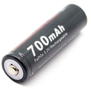

To power the electronics, I plan to use a LiFePO4 battery. A battery of this type has a voltage of around 3.3V, so it is capable of running the electronics directly, without a voltage regulator. It also has a quite large capacity (mAh per gram) and is relatively safe (doesn't catch fire easily, unlike some other lithium battery types).
