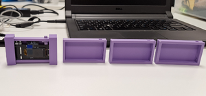

Case
Nemo's version: https://www.printables.com/model/1133397-nemo-de-beun-epaper-access-point-case
