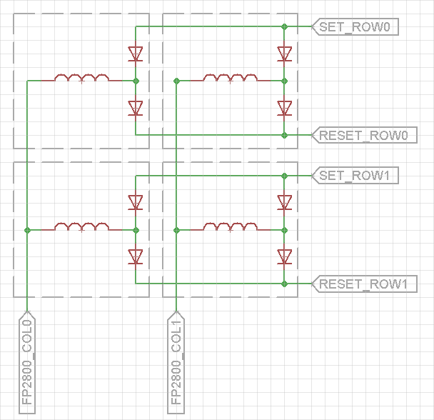

[File:pixel_wiring.png|How individual pixels are wired in a flipdot display] | [[File:pixel_wiring.png|How individual pixels are wired in a flipdot display (from: Reactor23 web page)]] | ||
The image on the left shows how pixels are wired with respect to the ROW_H, ROW_L and column signals. | The image on the left shows how pixels are wired with respect to the ROW_H, ROW_L and column signals. | ||

This software drives a pixel like this:
- select a row by making one ROW signal high: choose ROW_H_x if you want to set a pixel, or ROW_L_x if you want to clear a pixel. The rest of the ROW_H/ROW_L lines are made low.
- select a column through the COL_ADDR_x pins. The encoding is a bit tricky: a panel of 28 pixels wide has 4 groups of 7 columns each. Pins COL_ADDR_A3/A4 control which group to select, pins COL_ADDR_A0-A2 select (column+1) within the group.
- the polarity of the pixel (set/clear) is encoded on the DATA line
- a strobe (pulse) is sent to one of the panels by toggling one of the Ex lines high then low, to actually update the pixel
It appears that the ROW_H_x/ROW_L_x signals are driven directly at high voltage (18V or so) from the control board, while the COL_ADDR_x signals are at logic level. The FP2800 on the back of each flipdot panel then takes these logic-level signals and turns them into high-voltage (18V or so) column signals.
Possibly we can update an entire column at a time, by making several ROW_H_y/ROW_H_y signals high at the same time. Not sure if it is possible to both set and clear pixels in one go, or if it needs two passes: one to set pixels and another to clear pixels.
