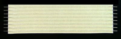

An example of the kind of ribbon cable I have in mind: | |||
[[File:S-l1600.jpg|400px]] | |||
wire thickness of the round ends = 0.51mm, length of wire end = 3.18mm. | |||
Meaning they will mate with samtec precision machined socket strips. | |||

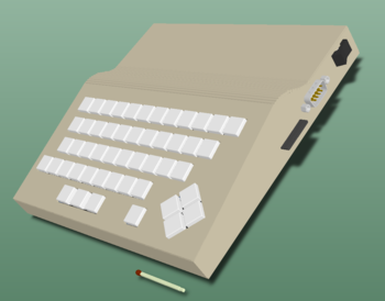

== 19 december 2018, investigated a design with a slanted keyboard == | |||
Made a 3D model of the keyboard PCB, mounted to a 2mm thick plate with brass spacers (M3 brass screw in spacers, 5.8mm long) the spacers are glued into pieces of plastic, glued to the plate underneath the four screw holes in the PCB, so that the keyboard is hanging on the underside of the plate. | |||
This model was slanted 10 degrees so that the main PCB could be partly shoved under it. | |||
A side view of it was generated, and that looks like this: | |||
[[File:RhoCoCo 3D preview rendering with slanted keyboard.PNG]] | |||
wire thickness of the round ends = 0.51mm, length of wire end = 3.18mm. Meaning they will mate with samtec precision machined socket strips.
Made a 3D model of the keyboard PCB, mounted to a 2mm thick plate with brass spacers (M3 brass screw in spacers, 5.8mm long) the spacers are glued into pieces of plastic, glued to the plate underneath the four screw holes in the PCB, so that the keyboard is hanging on the underside of the plate. This model was slanted 10 degrees so that the main PCB could be partly shoved under it.
